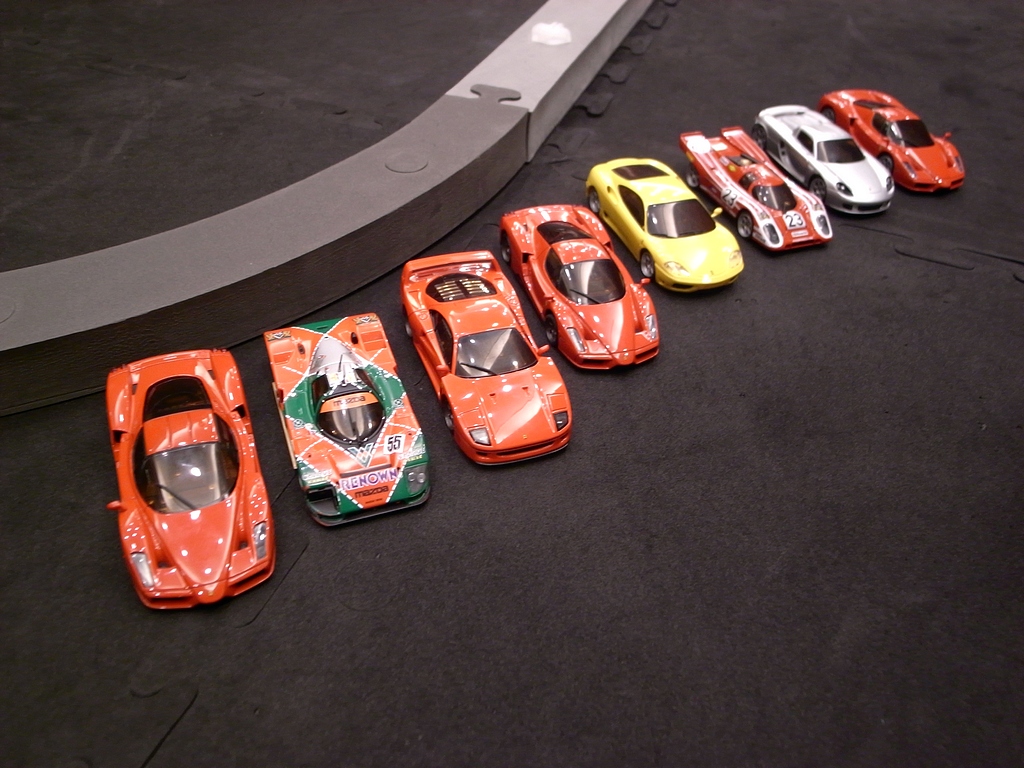

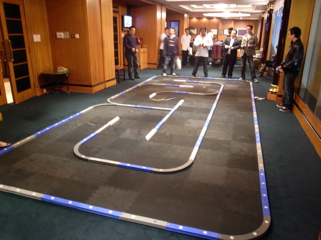

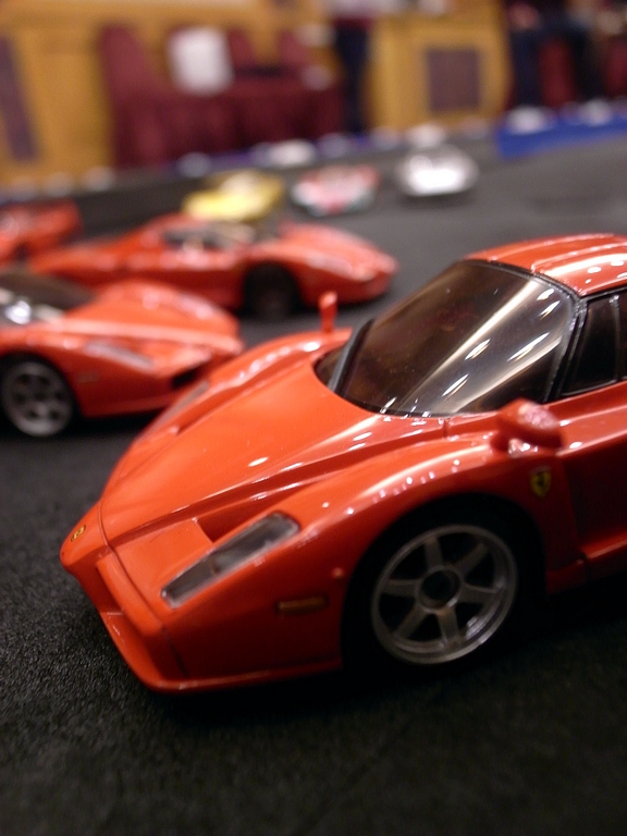

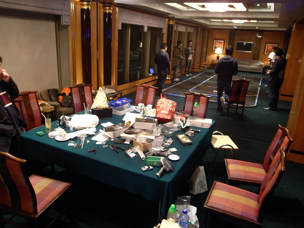

Here's our home track over in Hong Kong

thanks for the picture of the unit. please give us your impressions of the software.

Cool! Where are you guys? I'm in hong kong too.

looks like model selection for u guys is just as limited as it is for us here in thailand. how do u feel about dnano performance on RCP?

Hi J! Good to know you are in Hong Kong too! Usually we meet at the dNaNo shop in Mongkok during the weekdays and run on our private track in the weekends. Let's meet up in the Mongkok shop! Can you go around lunch hour during the weekdays?
We are getting more dNaNo cars as we speak in Hong Kong. We just got the Countach and the R8 complete sets yesterday. But the biggest problem is parts as we get nothing. 4 of my friends broke their servo gears or tie rod and there's no stock. All the tires are gone too not to mention ball diff, gyro and X motor. Demand for parts in Hong Kong is super high but there is just no supply. Hey NanoTrax you think I can order from you?
With stock #50 front tires the dNaNo cars feel too grippy on the front for RCP tracks. Just turn the steering and the car would do a 180 degree spin. We find that #60 front tires would run the best on RCP. Also since the grip is good on RCP we find the HM chassis is a bit quicker than MM chassis. The HM is more nimble around the tighter corners and yields a quicker laptime.

you mean RM? (i see u have several RM chassis cars running in your pics, no HM) ... i have very little stock myself KevTSE ... i do have a few things though: front tires (various hardness), ONE x-motor, a good number of wheel sets but all size 18/19, a few replacement parts & 2 sizes of aluminum wheel hubs. i would say check my site for what i do have in stock but i've been told not to do that here
