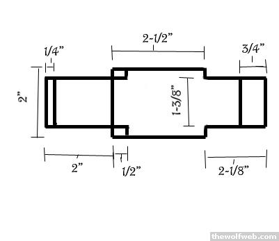

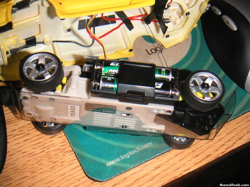

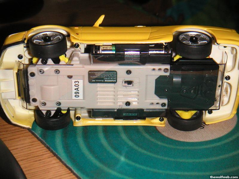

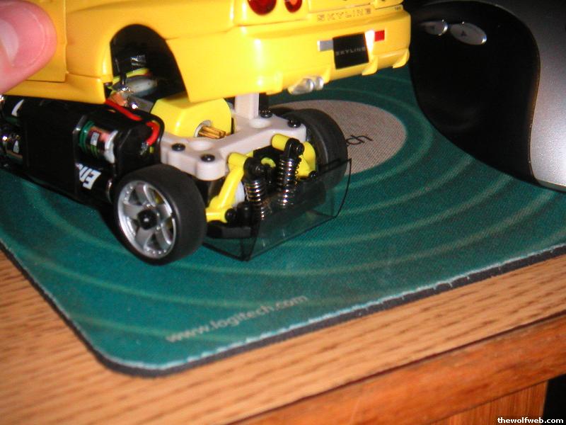

here's the pics, let me know what you think...to get the length you need to make it go up under the rear bumper, just add 1-1/2" to the previous diagram for the skid plate...

Wow....I'm very impressed. That looks awesome, I'm gonna have to do this myself. I was a little hesitant about the plastic being round, but it turned out great. Any problems with it wanting to return to it's original shape? I take it you cut a little slit where you made the bends?
Again...nice work!

Tutie:
1. Find a 2-liter (preferrably empty and cleaned) bottle of your favorite soda (cheerwine for me)...hehe
2. leave the label on, as this is how you get the straightest cuts...
3. proceed to cut the bottle with scissors along the top and the bottom of the label...
4. Next, cut the label from top to bottom, so it's no longer a cylinder.
5. This is the important part...you need to roll the plastic in the opposite direction of the curl...and put 2-3 rubber bands on it and leave it for a while, prolly overnight is best.
6. I changed basically one thing on the posted dimensions of the aluminum skid plate the length of the rear end...add exactly 1-1/2" to the end of the rear piece, but i will now make a drawing of the thing with dimensions on it as i have measure them just now, hehe...
