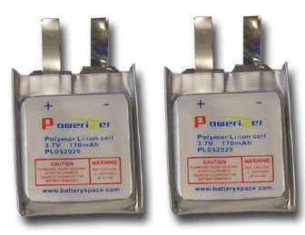

well all is not joy and happiness today... the little 4-cell battery pack that I use in my TTTT truck is no good.... when I plug in the steering servo, it steers fine...when I plug in the ESC, it runs cleanly... when I have them both plugged in...the truck shakes and shudders and jerks around like it's having an epileptic seizure..... I took the 3.7v lipo pack out of my Canon SD400 camera and touched some connectors on it and attached it to the truck and it ran fine...less voltage....runs great...four mini cells 4.8v...runs like crap... my guess is that the 4-cell isn't putting out enough amperage...either way... I can't run my truck until I get something different....not happy
so I ordered a couple of single 170mAh LiPo cells... these are the exact size to fill the empty space in the bed of my truck (24mmx19mmx4mm...so hopefully they will work)
I was really hoping to be driving the heck out my truck,... but there seems to be another setback....oh well

more good news... I found a local source for single cell 145mAh Lipo cells so i bought four this past Sunday (today's Wednesday).... and they work and fit great!! (see above pic)
also the two cells I ordered came in today... and they are 170mAh and they fit as well... so now I have 6 LiPo cells and they all fit and work...yay!
