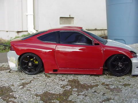

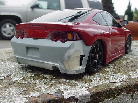

i made a new thread b/c it had too many links. i'll post pics directly on here now so it'll be easier for you guys. i ran my rsx the other days and......stupid rocks!!! chips/scratches here and there but not huge marks. some of you guys remember the hood i was doing, unfortunately i destroyed it b/c teammnm wouldn't believe that i do my own authentic handmade work. rushed the paint job which i should have NEVER done. but it's decent. the plan right now is pretty much the same when i left it. rear will be a buddyclub 2. hood will be mugen. front will be from the Chargespeed Acura RSX DC-5. now straight to the point.clear pics to show the shine and reflection just like a real car!!

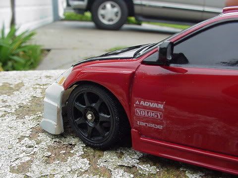

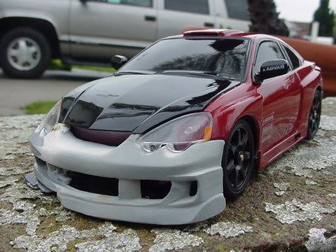

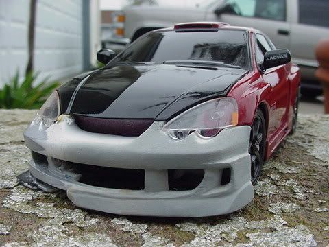

this forum isn't as active as it used to be, huh?? well anyways here's an update. the chargespeed front is taking shape. not much done to the rear and hood because it's not as fun as the front. what you guys think?

It looks good,, What material are you using to modify the bumper? are you using bondo?(i would think that would be too heavy) or some sort of foam?(too soft for impact)
Thanks
Sporttracguy
  #13
Old 01-18-2005, 10:28 PM
aznballa2k4 aznballa2k4 is offline
TinyRC Pro
Join Date: Dec 2003
Location: california
Posts: 51
Send a message via AIM to aznballa2k4
i'm using Tamiya Epoxy Putty Quick Type on the bumpers. its hard as rock when it dries. if i were to use bondo for it and run the car, it'll snap within a couple seconds. i think the epoxy is as light as bondo but it is a lot stronger than bondo. i'm not much of a performance guy so it doesn't really matter about weight or anything. i have another rsx body too. that'll be the one i'll use to play with. sooner or later that body will probably be another project too...
