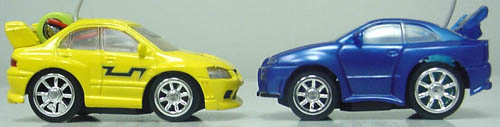

Pics finally
Here's a pic of my lowered Lancer with a stock Skyline for comparison. I did the body filing like I mentioned but after the dual cell mod it didn't sit low in the front any more so I removed the spring.
Lowered profile
